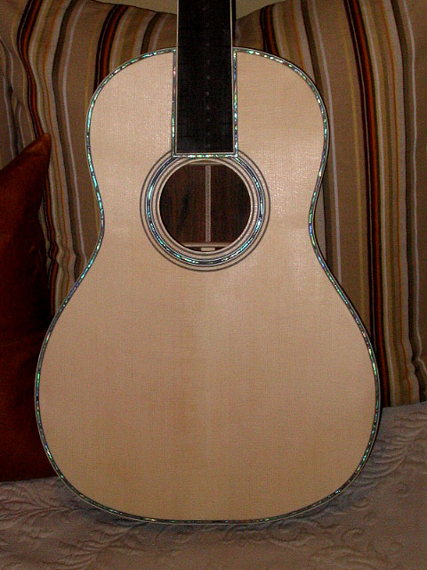

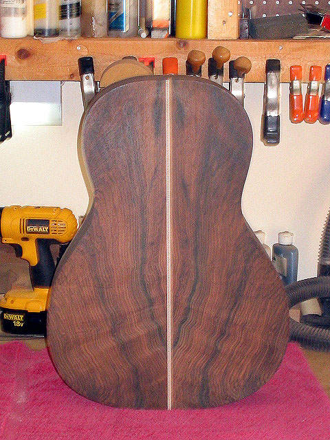

I've long been interested in vintage instruments and decided not long ago to invest some time and effort into researching guitars built in the 20's and 30's. I've had an opportunity to play quite a few old Martins from that era and every one of them had one thing in common. They are all light as a feather.
I've switched gears and am starting some vintage style instruments, doing things "the old way". Dovetail necks, 1920's style bracing, thinner plates and rims, all based on plans from actual vintage instruments. It's quite a change from my normal guitars, but it's a lot of fun.
Here's a couple of progress pics. Brazilian/Adi 12-fret 00 body style with 42 trim. Woodworking should be finished in a few weeks. Thanks for looking.
Jimmy Caldwell

   That is awesome!! I love those vintage featherweight guitars. I've owned a
bunch of Martins from that era and have repaired and restored a dozens of
them. Each time one would come through my door, I would measure and
document alot of the dimensions in them with the sole intention of using
them one day to do just what you're doing.....building guitars that are truly
in that style.
    Beautiful work and gorgeous woods. I love that 42 style Abalone purfling,
too.

Jimmy: I have also started a guitar in the 20's style. I'm looking for just the right mahogany to pull it off and it will be quite a bit plainer than your beauty. My question is about the "20's style bracing" would you please elaborate?

Thanks for all the kind words. For anyone interested in building vintage instruments, I'd recommend doing a lot of research. There is a ton of information available on the net, but the best information is found in the guitars themselves. Find as many as you can and get out your inspection mirror. Play them, feel them, and look inside. You'll likely come away saying "I can't believe that thing hasn't exploded by now". One of the best things you can do is find a mentor. Someone who has experience with vintage guitars and really knows what it is about them that differentiates them from contemporary instruments. You have to rethink the way you do things and it's very comforting to have an experienced voice coaching you. It's far more than a body shape or some abalone trim and the true connoisseurs will know the difference. Things were done differently back then and as the guitar has evolved over the years, we've lost some of the magic of these old instruments for a variety of reasons. Don is right about the height of the bar. There are some incredibly talented builders out there doing this type of work, and their instruments are in great demand.
For those who asked for pictures, I'll try to get some posted in the next few days. And Tony, the jig I made for abalone around the FB extension is super simple. I'll get a pic of it up also. I've seen your work and this will be no problem for you.Jimmy Caldwell39066.4818981482

You've posted (and are building) my favorite Martin shape. I've got a 12 fret 00 Martin from their custom shop (modern guitar), and have one question for you:
how many frets do the ancient ones employ?
My guitar uses the full 20 frets, plus adds some length to the end of the f/b, pushing the soundhole back further (in my opinion) than it needs to be.
Would love to know what your research shows, and what you yourself are doing w/ that one point.

19 frets is correct (I must have been having an AARP moment). I'm trying to remember the dimension from the center of the soundhole to the edge of the top and I think it's 6.5". The soundholes are 3.75". I'll double check that tonight and let you know.Jimmy Caldwell39067.4068402778
